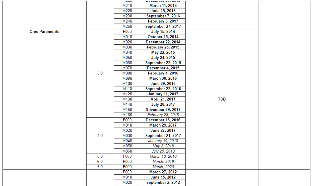

There is a neat tool called Product Calendar that will show you when updates are scheduled for release and when they are actually released.
http://support.ptc.com/cs/product_calendar/PTC_Product_Calendar.htm#RANGE!A238
The user community would not have any information on why PTC missed a projected date for a release. Very few PTC product managers or support people visit the Community. Your best answer will come if you open a call with PTC tech support.
Calendar shows that Creo 4 M040 is delivered on 5th January!
I open a support case but I hope you have more information than me.
Thank You.
Calendar shows Creo 4.0 m040 is scheduled for release on January 5th.
When a date is in italics it is the anticipated release date.
The date has been changed since earlier!
It is now scheduled for January 19th.
It looks like the date has slipped to January 19th. (This is not uncommon with maintenance releases.)

M040 Was rescheduled for Jan 19th, and as of 2pm still not posted on Jan 19th.
I wonder if it is going to be delayed again.
Chris
cruf
(To:cruf)
4.0 M040 is now posted, yea.

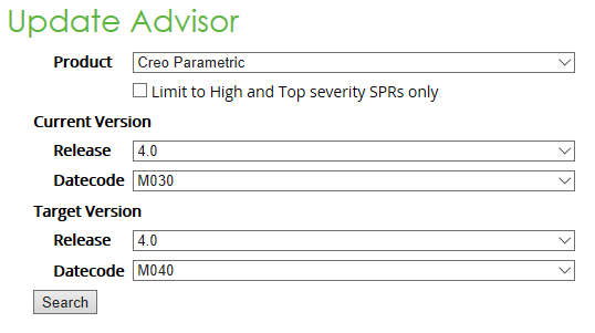

Is there some sort of changelog?
TomU
(To:Ziegi)
Not publicly available.  The best you can do is update advisor.
TomU
(To:Ziegi)
You might find this useful as well: https://www.ptc.com/en/support/article?n=CS251133
VladimirN
(To:TomU)
And in PDF.

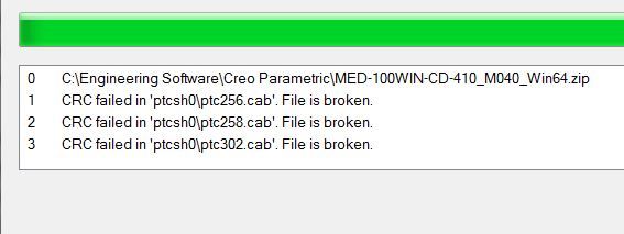

Is anyone else having issues with unzipping M040?
I downloaded the file twice and tried 2 different zip software but I'm still getting the below error.
cruf
(To:pimm)
I had no problem unzipping
TomU
(To:pimm)
7zip was complaining about a header error but the Windows built-in zip tool unzipped it just fine.  So far I haven't seen any issues with installation or usage.
