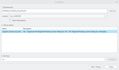

What is your setting for SUPPRESS_LICENSE_LOSS_DIALOG?  I'm getting the feeling that Creo may be waiting for input from another window when this happens.
SUPPRESS_LICENSE_LOSS_DIALOG is set to "No"
Change it to yes.

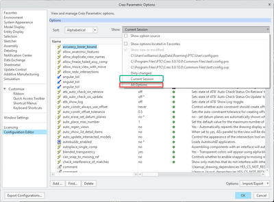

@Michael_ Just a note, when you use "find" in the config.pro options, the * (asterisks) next to the value means that you are seeing the "default" value, not  the "set" value...it confuses most everyone.
If the option is already "set" in your config, for example to yes, when you search like this, the asterisks still shows on no, because it's default, not because it is set to no.
To verify what a setting is actually on, you have to look at your options, I used the "current session" drop down in the list so I see ALL set options that have been explicitly defined but you can us "all options" to see the value of EVERY setting, even if it is not explicitly set (aka, default).

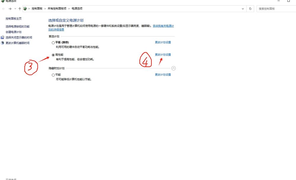

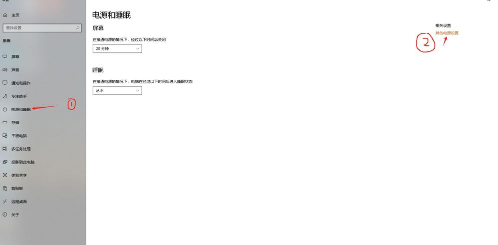

会不会是电脑使用了睡眠或休眠模式,可以尝试一下电脑设置微信截图_20250723090629.jpg微信截图_20250723090732.jpg微信截图_20250723090749.jpg
I've removed hibernate as an option in the sleep settings and also set the display to never turn off on battery and plugged in.
