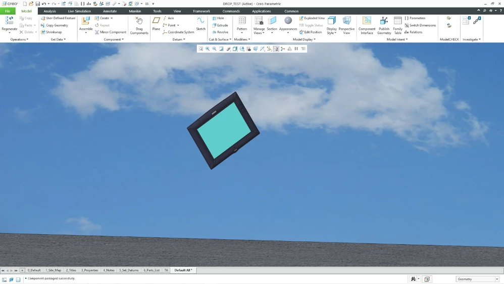

Here is a phone drop simulation created about 15 years ago by my former colleague Roberto Sanchez from NxRev. I will write about it in the blog post. It was made in MDO and involves cams, dampers, position motors, and a dynamic analysis.
This challenge is open to resellers and PTC employees. If anyone wants to show their prowess and represent their organization, they have until Friday.
