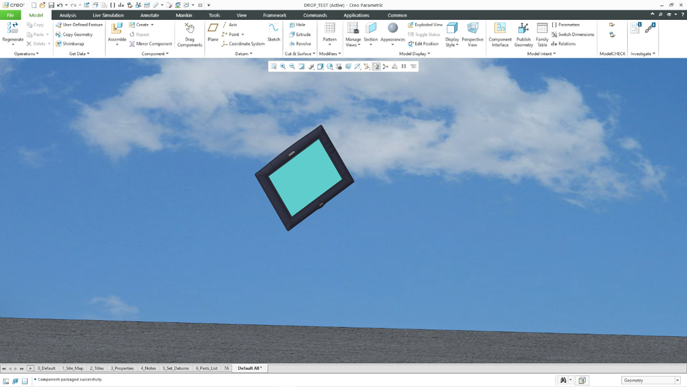

Here is a phone drop simulation created about 15 years ago by my former colleague Roberto Sanchez from NxRev. I will write about it in the blog post. It was made in MDO and involves cams, dampers, position motors, and a dynamic analysis.

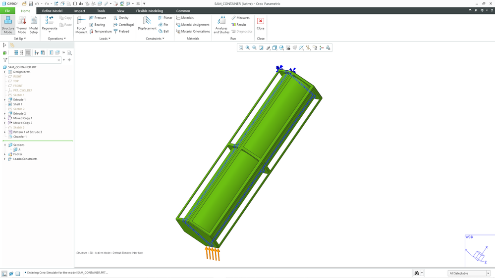

I will write about my experiences with drop tests in the summary blog post. I was going to replicate a simulation I developed in the 1990s for a shipping container for a surface-to-air missile. But then I realized I was lacking the necessary Creo Simulate license. (I suspect licensing may explain why there were so few submissions this month.)
As this was decades ago and computers weren't that good, I had to use a technique I wasn't crazy about, but it was the best we could manage back then. We would choose an orientation for the drop, and then use a three-point constraint on the end opposite where it would hit the ground. You have to have constraints in a static analysis; otherwise, it won't run.
Then we would apply a force corresponding to several G's of acceleration where it would hit the ground. Since we were using NASTRAN at the time, we would use what corresponds to a Dynamic Shock analysis where that force would be applied over a very short duration. (This, by the way, was before PTC acquired RASNA, which would become Mechanica, which would later become Creo Simulate.)
Maybe at some point I'll get the advanced license of Creo Simulate in order to demonstrate this technique.
