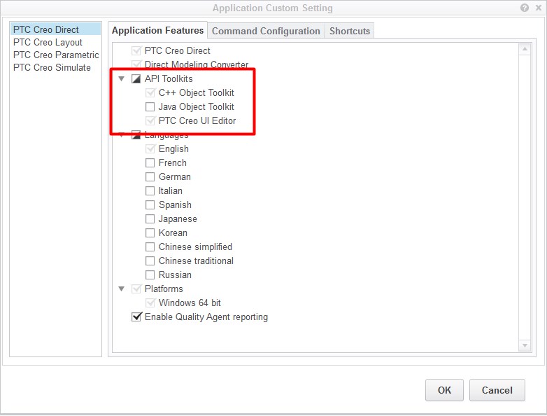

Hello again,
Yes this should be the one. But I can't seem to spot it therefore I assume is something that I have not currentl;y installed. Can't seem to find on setup either though:ptc.jpg

you will see Toolkit items when you click Customize button in installer window. Toolkit items are available in Creo Parametric "area". Some of them need special license, some are free.

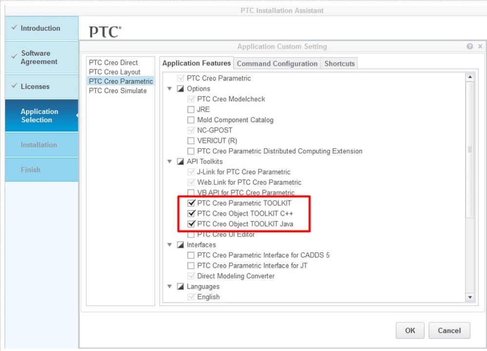

unfortunatelly three Toolkit items in red frame are not free. You have to buy a license to use them.

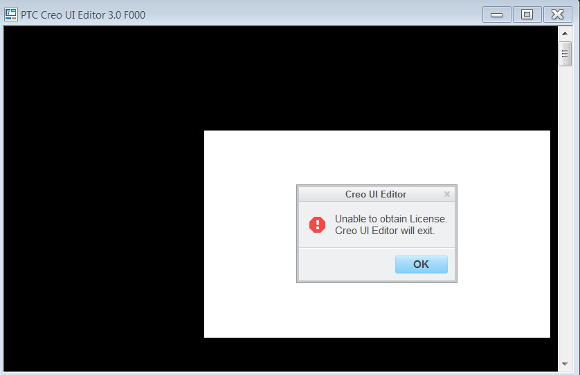

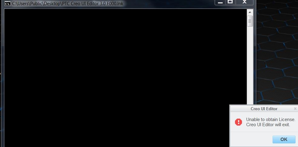

I don't have a trial version. I have an educational one (slightly different) provided by my university. Though it allowed me to install this error appears. Does that mean my licence does not cover those addons?Screenshot_1.jpg
"Does that mean my licence does not cover those addons?"
It depends on the contents of your license file. Open it in Notepad and look for Toolkit keyword. you can also upload your license file and I'll tell you what is inside.

in parametric.psf you can find license name, only ... in your case it is PROE_Educ1. To see list of modules available in this license, you can:
  • look into license.dat file located on license server
-OR-
  • launch Creo and click File > Help > System Information and look into Configured Option Modules section
Martin Hanák
So... They seem to be included. How can I access them?
during Creo installation, you have to click Customize button and select Toolkit items to install them. Then you have to learn how to use them to create an application. Programming using Toolkit is not easy and I can't help you to learn it.
