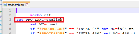

@MN_10661566 wrote:
Creo10.0.0.0
I defined personal environment variables ... see env_var.mp4 video
DBATCH_FORCE_CREO_RESTART = Y
NMSD_TIMEOUT = 15
I modified ptcdbatch.bat
I started ptcdbatch.bat  and run mytask.dxc
<DXC>
    <Windchill/>
    <Group DSQM="_LOCAL" Name="IGES 3D Export" Output="2" OutputDir="E:\users\creo10_parametric" PrimaryContent="0" TTD="E:\PTC\Creo10_000\Creo 10.0.0.0\Common Files\text\ttds\iges_3d_export.ttd" VaultResults="0">
        <Object>E:\users\creo10_parametric\brick.prt.1</Object>
    </Group>
</DXC>
nmsd.exe disappeared after expected timeout.
Note:
I think it would be better to check, whether xtop.exe process exists. Because of DBATCH_FORCE_CREO_RESTART = Y Creo session ends when task is finished.

@MN_10661566 wrote:
Creo10.0.0.0
NMSD_TIMEOUT = 15
<DXC>
    <Windchill/>
    </Group>
</DXC>
Note:
Martin Hanák
