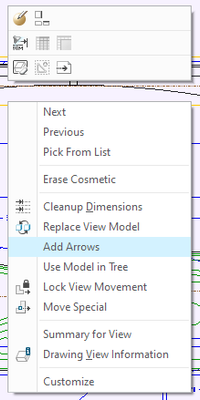

I have always selected the sectioned view and selected Add Arrows from the RMB menu then select the view for the arrows.

Looks to me that the RMB menu doesn't have the Add Arrows option anymore in CREO 10. Those icons are to half/double the spacing or change the angle.
you selected hatching. You have to select view.
Martin Hanák
Thank You again. That does work. The small changes from CREO 10 are tripping me up.

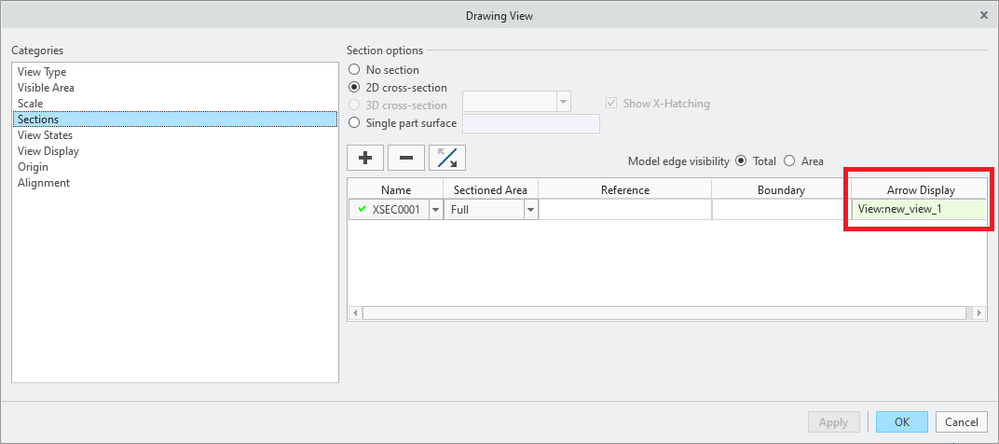

Used to be you had to select the Hatch lines itself otherwise you get the placement arrows for the view, not the cross-section plane. On CREO 10 it works if you select the view that has the hatching,  not the hatch lines itself, and then you can find the Add Arrows in the RMB menu.
Martin Hanák
That does work, thanks. I didn't see it as my Drawing View menu is cutoff after the Reference Option. I had to use the scroll bar to scroll over to see that extra option even though I have a wide monitor.

I am not using Creo 10 yet so I am not able to test this, but you should be able to customize the pop up menu by adding the command you want. You may be able to add the command directly to the menu or if not then create a mapkey to add it.
Involute Development, LLC
Consulting Engineers
That works as well. I teach a lot of students so am trying to teach them without having to customize. But I was able to add the Add Arrows tool to the pop-up menu which appears after clicking on the hatch lines and holding RMB, and then using the customize option in that menu - Open in Options - and then dragging the Add Arrows tool onto the menu.
