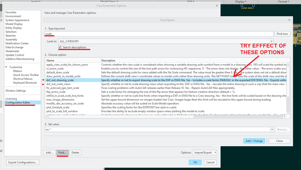

Not sure, but perhaps you can try modifying your system configuration:
please provide:
  • Creo model + Creo drawing for testing purposes
  • config.pro
  • dxf_export.pro
Also attach picture of Creo window with marked problematic items.
Also attach picture of 2D software window with marked problematic items.
