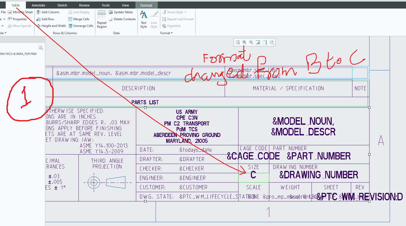

The table in .drw is not updating if I change .frm save and reload. Somrthing in .drw is not updating to see latest format file.
SEE IMAGE of .frm and .drw
Change in .frm [B TO C]
Upadte in .drw still show B

Update in .frm TABLE does not update in .drw TABLE (SAME CELL). Nothing to do with B or C format size.
In another words,
Once captured table cell input from .frm by .drw NEVER CHANGES even the input in table cell of .frm is deleted/changed.
you described standard Creo functionality.
When you create new drawing using .frm, Creo copies tables from .frm to .drw. These copied tables are independent on tables defined in .frm.
Suggestion:
  • remove current format from drawing ... apply simple frame available OOTB
  • do not forget to remove all tables when you are asked
  • set new format
