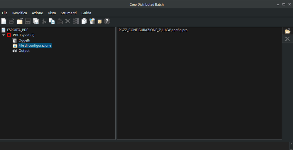

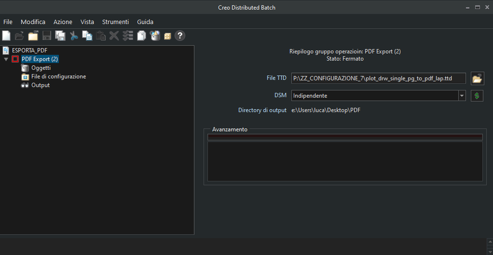

hi,
i fix my problems by setting the creo distributed batch like this:
i copied the plot_drw_single_pg_to_pdf.ttd in my config directory, changing its name.to plot_drw_single_pg_to_pdf_lap.ttd
and i modify some things.
Like getting monochrome print instead of colors
<color enum="PRO_PDF_CD_MONO"/>
or cad fonts instead of true type for example
<font enum="PRO_PDF_STROKE_ALL_FONTS"/>
exporting all sheets instead of a single one
<sheets enum="PRINT_ALL_SHEETS"/>
(in the end of post the complete ttd xml file)
then i create a distributed batch pointing to that file
dsm indemendent
in the configuration file i added just my config.pro that have inside all information about colors plotter and pen table.
it works. some time i have to run the task and manually select the objects, right click and send them again.
