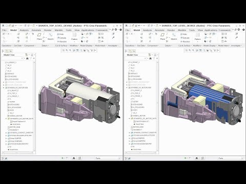

I am not sure of map key, can you provide link to assign map key. Have a look at this video https://www.youtube.com/watch?v=dGafJHgppD0 from 0:22, when the person chooses assemble the file type is set to all files. If this person can have this setting, there must be a way which I am unsure of.

according to https://www.ptc.com/en/support/article?n=CS38304 setting Type=All Files is not possible. I suggest you to open Case at PTC Support and send them the link to youtube video.
Martin Hanák
How can you be sure the video is not edited?  As for mapkeys - please search the forum, these have been discussed before plenty of times.
