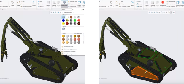

Assigning an appearance to an assembly helps you visualize the finished product. So, what happens when you have appearance variations? With Creo 4.0, now you can assign “appearance states” to those variations. You can even link them to assembly combined views. Let’s get the details from an expert:
In the View Manager, you can now set the appearance state of your component, assign multiple appearances to the same component occurrence, use appearance states inside combined views, and easily switch between appearance variants.

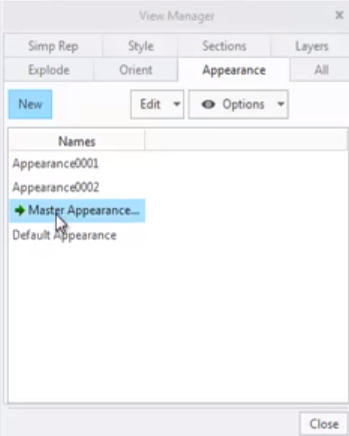

Use the Master Appearance to start assigning appearances from a clean sheet. The Master Appearance can be changed but can only be saved to a new appearance state, which will be automatically activated after it is created.
Changing the appearance of the Master Appearance.Changing the appearance of the Master Appearance.
A plus next to the appearance state name in the lower left of the graphics area indicates when the master is being changed. Reactivating the Master Appearance will reset the applied changes.
Reactivating the Master Appearance in the View Manager dialog.Reactivating the Master Appearance in the View Manager dialog.

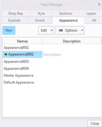

You can add a description to the appearance, and it will appear in the Description column of the View Manager.
A description was added to Appearance0002.A description was added to Appearance0002.
