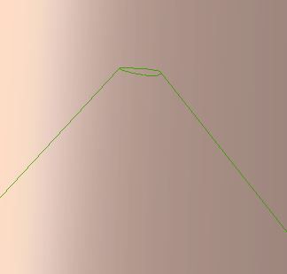

Hi guys, I did a resolve for my main body and in the sketch, I make it as a cone, as shown in the picture. But after the model is completed, it does not become a cone, instead it has a flat surface rather than a pointy shape.

A revolve is created by rotating about a centerline. The centerline is either a sketched centerline in your sketch or an axis that you selected from your model. If you want the cone to come to a point, the "top" of the cone needs to be exactly on the centerline.

@WC_9024124
You may try changing the accuracy of part.
If possible share the part to review.
