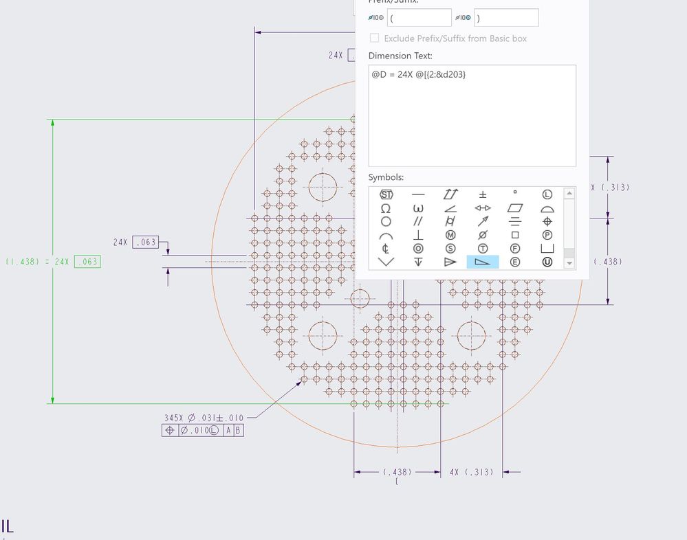

 Dim Text Mods.JPGI am modifying dimension text in Creo 8. Is there a comprehensive list of text modifiers, such as @O for override or  @[{&D203} to display dimension 203 as basic when being referenced inside another dimensions dimension text?

Here are a few of the most popular text mods:
  • Overwrite Dimension: @O
  • Box around text: @[***@]
  • Superscript: @+***@#
  • Subscript: @-***@#
  • Super/Subscript {0:***}{1:@+***@#)@-***@#
  • Multiple formats:
    • To edit the style of one section of a note, first click to select the entire note, then click again to select just the section you want to change. You can then RMB -> Text Style... and change size etc. as required.
    • This works directly with separate lines within a note, but to change just one part within a line you must first separate that section by adding {1: and } around the relevant text:
    • {1:Large Text} Small Text
    • Separate Line
    • Then close the note editor and proceed as above.
  • Round Parameter Value:  add [.X] after the parameter name, X being the number of decimals.
  • Leader Location on Note: add @O to line on note.
  • Use & or @:  Type twice in note e.g., && or @@
You can also look at Creo Help.
Text Strings (ptc.com)   - Detailed Drawings > Annotating the Drawing > Working with Text and Notes > Modifying Note Text > Text Strings

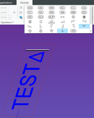

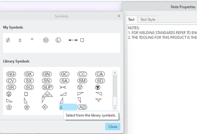

Do you know what the text mod for adding a delta into a note? Currently we are placing a symbol and relating it to the text, however, it's from what a few coworkers have told me there is a way to add it directly in a notes text.
kdirth
(To:PF_9790518)
In Creo 7, Delta is in the text symbol list
Here is how to place a symbol inside a note:  Place symbol in note by placing note in drawing first then in note type &sym(symbol name).  Symbol may be deleted from drawing.

I am seeing this when I edit a note in a drawing in Creo 9
That is in drawing.  I get the same options in model.
StephenW
(To:PF_9790518)
If you are refering t symbol like a custom symbol from the annotate tab, symbol, custom symbol.
&sym(SYMBOL_NAME)
for example, I have a custom symbol named note_sq, so to show it in a note, it would look like this:
&sym(NOTE_SQ)
