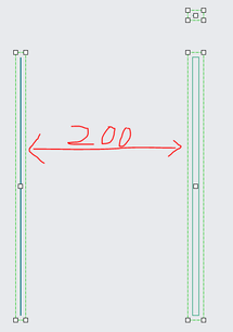

I explain my problem to you:
I need to make a 1: 1 scale plan template, the problem is that when my parts are too big, when I use my plan template, all my plans overlap (I don't know where is the left or right view) and I have to replace them by hand
So I wanted to know if it was possible to be able to give a distance between the GABARIT_VUE?
I give you captures of what I imagine
(in the creation of the template plan)
(what it would look like with a piece)
Thank you so much
Maxence

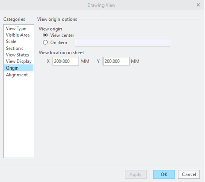

I don't know of a way to offset a view by a specific distance.  However, you can specify the location of a view in the View Properties.  Changing the Origin location will move the center of a view a specified location.  Using his you can use the location of the first view to place the other views a specific distance away.  Since the view size also incorporates all datums and hidden features the actual distance between view images will vary greatly.
Thanks for your quick reply, however i don't think this solution is workable.
First of all, I don't think I can specify this parameter when I edit my "view template" and then I would have to manually enter the value in the parameters (which will take me longer than replacing them manually. .)
PS: I know that what I ask is possible because I have already seen a person do it (but I don't know how they did it)
Thank you so much
Maxence
