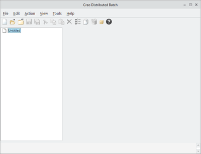

when distributed batch is installed, then you can see ptcdbatch.bat in Creo Parametric\bin subdirectory.
When you start this tool, following dialog appears
In this dialog box you can define batch processing task and save the definition in to dxc file for future usage.
