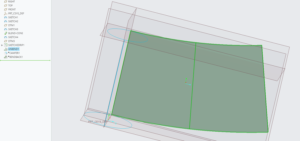

Doesn't chamfered cone shape unbend support yet?
hyarth

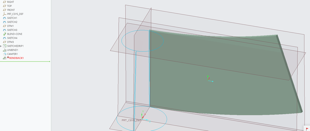

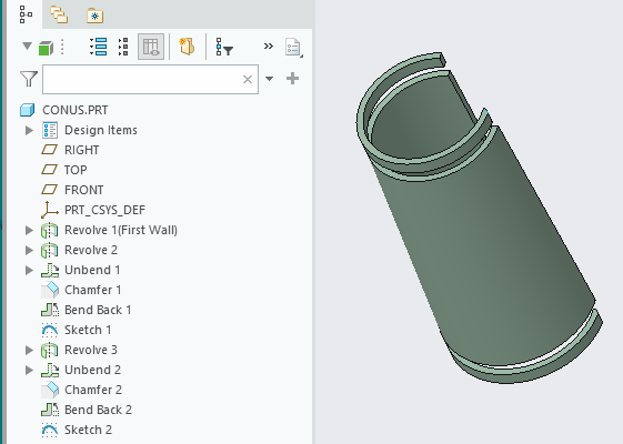

1. make a cone
2. sketched rip and chamfer
3. failed bend back
As a result, I want to bend the chamfered sheet metal to make a cone. Is there any other way other than this?

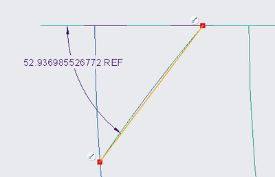

I added two cylinders to your model (diameter=916 and diameter=1100) ... see  following picture.
For both cylinders I did following steps:
  • unbend
  • chamfer 50 degrees
  • bend back
  • sketch using bent chamfer edge
Finding no.1
When chamfer surface is bent back then it changes from planar surface to curved surface.
This is why you cannot bend a bent cone back - Creo does not know how to deform chamfer surface.
Finding no.2
If you create sketch going through chamfer edge after bend back operation, you will get your angle.
At the top (diameter=916) it is 53.5 degrees.
At the bottom (diameter=1100) it is 52.9 degrees
So you know that the angle varies between two above values. >>> and this is the answer you are looking for (I hope).

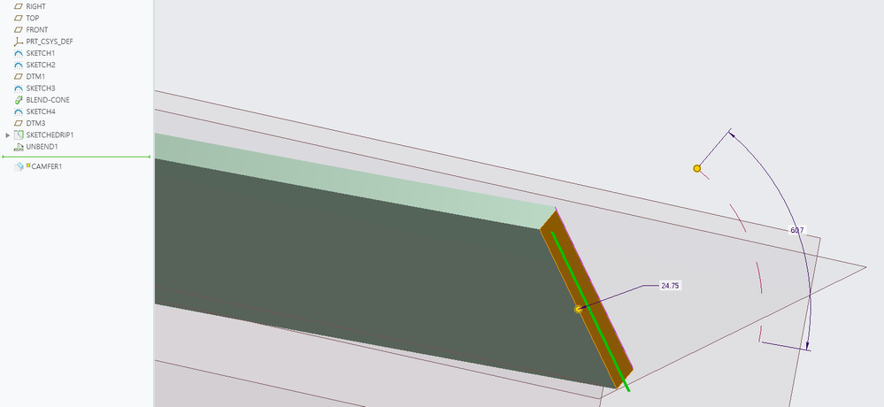

- sketch1's diameter is 1100, sketch2's diameter is 916, height is 2000, then I was blended.
- then I creat DTM3 to rip

When we bend metal sheets in factory, we cut metal sheet before bending. so I want to know the angle change  that occurs when bend with chamfering. If you know other procedure to solve this question, you can ignore my procedure.
hyarth
(To:hyarth)
For exaple, when champered 30degree metal sheet bended, angle changed lager or smaller like 27degree or 33degree.

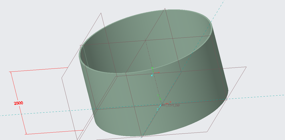

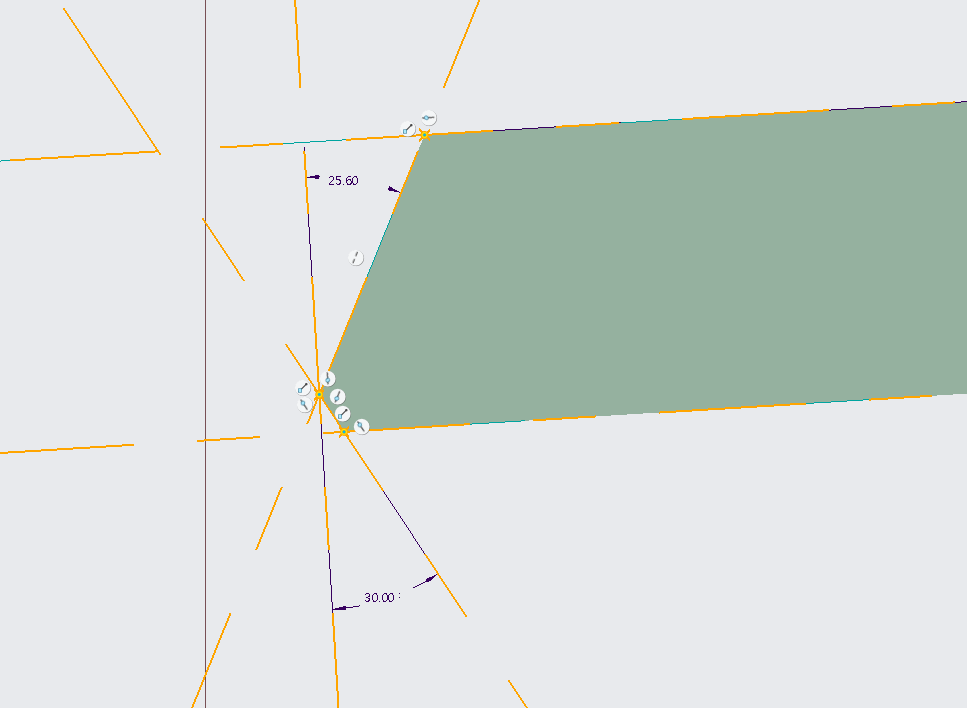

hyarth
(To:MartinHanak)

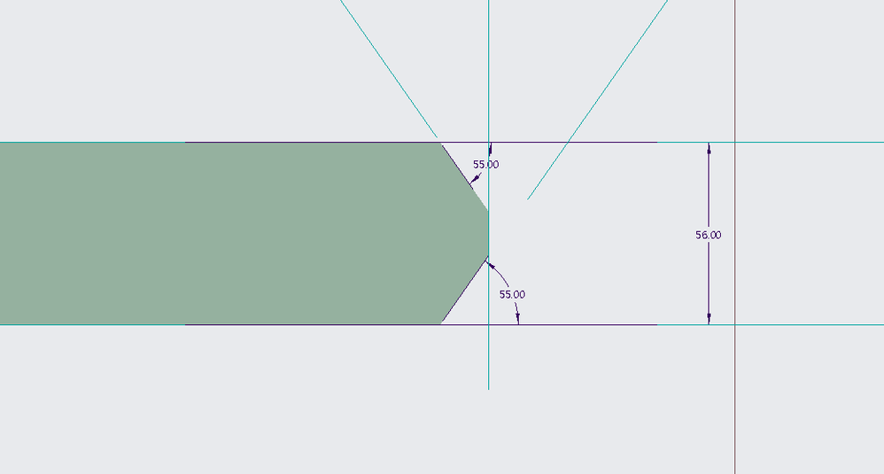

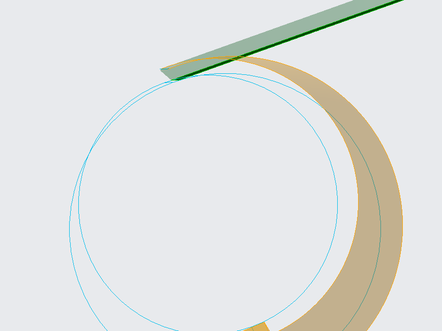

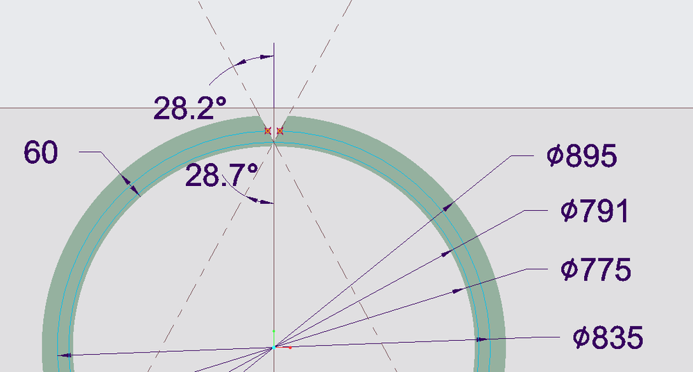

For example simply bending the cylinder, First, I made a cylinder with a thickness of 56 by spinning, then I made it into a flat plate by unbending.
Then, I chamfered it so that the angles were 55 degrees and 35 degrees for welding.
Third, if you bend it and remake it into a cylinder to measure the angle, the difference in angle will occur as follows. I want to do it at cone.
Here's another example

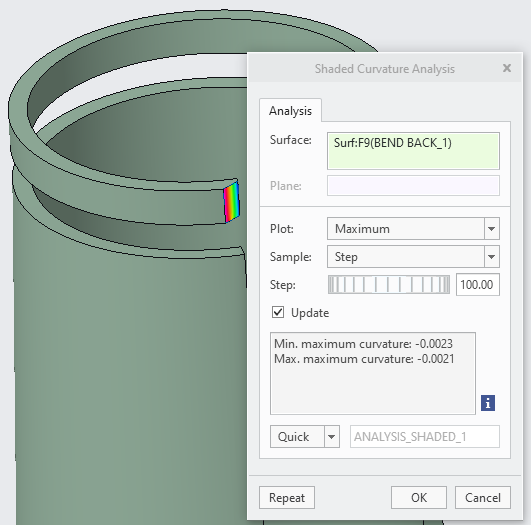

MartinHanak
(To:hyarth)
  • unbend
  • bend back
Finding no.1
Finding no.2
Martin Hanák

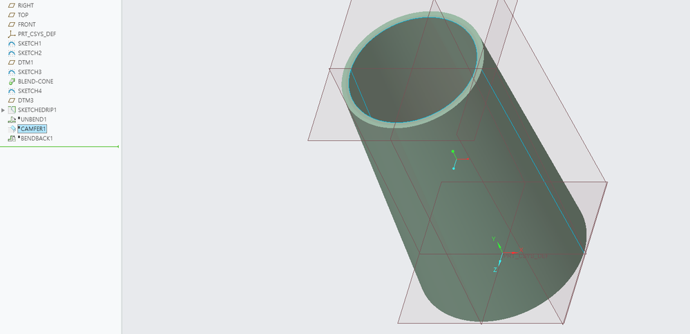

hyarth
(To:MartinHanak)
Yes that's what I wanted, but if this is chamfered inside the cone, it seems that bend back is impossible.
Could this problem be solved?
MartinHanak
(To:hyarth)
I opened model shown in my reply from ‎2023-02-24 02:37 PM, changed outer chamfers to inner ones and redefined Sketch features. Model was regenerated successfully. NO PROBLEM.

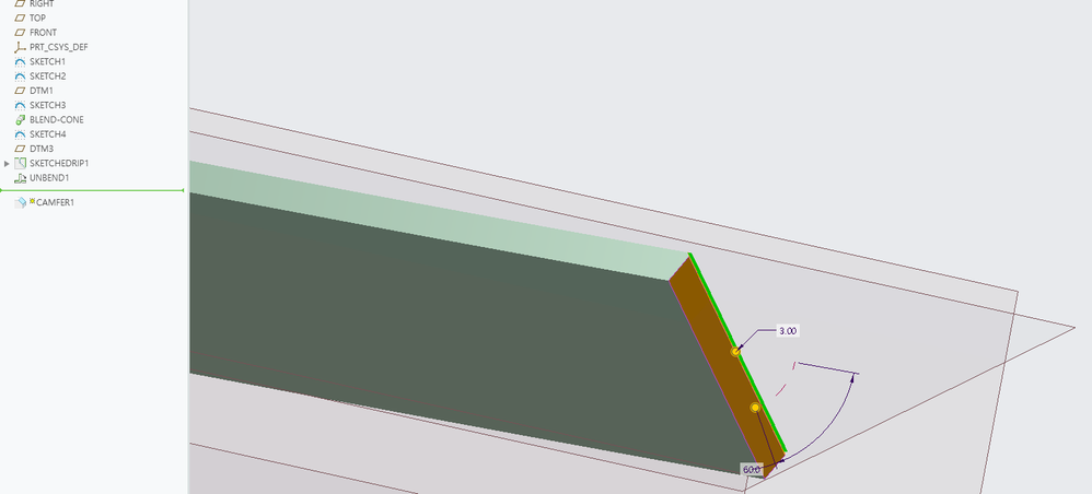

kdirth
(To:hyarth)
After a bit of experimentation, with a cone, it appears creo is unable to bend back a cone if you modify the end of the driving surface.
hyarth
(To:MartinHanak)
cone's thickness was 50
kdirth
(To:hyarth)
The bend back feature needs the original anchor surface, or at least a portion of it, to work.
Also, you don't need to unbend in order to chamfer the edge.
