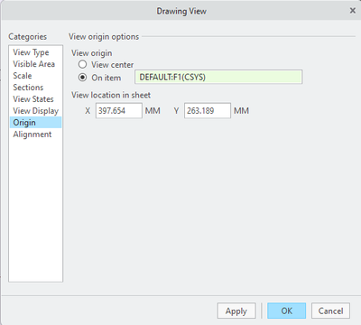

One of our designers has a drawing that was saved in January and none of the parts or the assembly have been modified since then, except the skeleton file that is used for positioning the assembly.
When he and I opened the drawing this morning from Windchill, most of the views have shifted locations and even dimensions on one view that did not shift have been moved from where they were in January.
This is very disturbing, especially the dimensioning and balloons moving in relation to their original placement.

I'll bet the view center didn't shift locations, but rather the size of the view changed making it look like it moved. Just for fun, open the old version of the drawing and write down the view center coordinates, then open the new drawing and compare. More than likely they will be identical.
If you want to make sure views don't move when the view size (view boundary) changes, tell the view to use some piece of geometry as it's center. (default csys, etc.) Likewise, make sure snap line for dimensions are tied to physical geometry and not the view boundary.

I've done this to myself in the past - doing something that causes the overall part "envelope" to increase and thus causing horrible dimension snarls on the drawings. The angle dimensions are the worst offenders. I wish there was such a thing as radial snap lines...
Can you please elaborate on this? Where can I find more information on dimensions referencing a default csys? I am having this issue with drawings of a multibody part, and it keeps messing up ~10 drawings each time it randomly decides to change the view size. Thanks!
In the view properties, select on item then the item (csys, vertex, point, etc).
This will keep the view from shifting on the drawing when the size changes due to a model change.
The only way to keep the view size from changing is to make it a partial view. To keep dimensions from shifting when the view size changes, use snap lines anchored to geometry or datums.

I'm pretty sure locking the views just prevents you from physically dragging them around. In this case I don't think the view center's position in the drawing changed at all, rather I'm guessing the view *size* changed due to where the geometry is located. This is where using a geometry reference for the view placement can help instead of letting Creo dynamically calculate where it thinks the view center should be.

Changing the origin of the view, in View Properties, to "On item" and selecting an edge of a part and/or feature that won't move would keep the view from moving relative to that part.
I actually don't believe it would. If Creo thought the view had gotten larger it would simply get larger around that new origin point, no matter where that new point was.
NOW, what if you made a cube of surfaces (extrude with capped ends), with your entire model (part, assembly, whatever) inside that cube, sizing the cube to be JUST a little bigger than you'd ever think the model would be, hide the cube surfaces, then place your views. THAT, should stop the views from moving around. So, doing that, and using geometry instead of view outlines for your snap lines should make the dwgs more stable.
