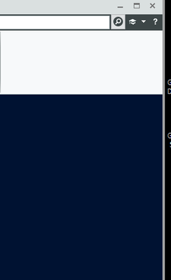

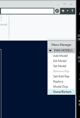

I am using Creo 9.0.5.0. When I replace models in a drawing, the drawing models menu manager is "hiding" behind the drawing instead of remaining on top of the drawing so I have to tab to it in order to be able to click on "Done/Return". Anyone else experiencing this? I moved it to the right, but after closing and reopening, it back to the same spot.

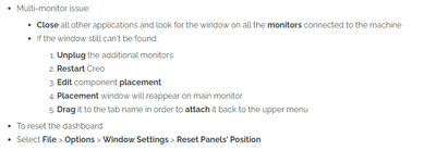

Can you please try this, Article - CS218107.
Not sure what I need to try. The window is found, it is just hiding behind the drawing window and won't let me execute a command until I find it and "Done/Return" it.
  • Rename .wf folder located at C:\Users\<username>\AppData\Roaming\PTC\ProENGINEER\Wildfire
  • Select File > Options Window Settings Reset Panels' Position
Mine was already set to:
I don't have a Reset Panel's Position option.
I did rename .wf and restarted Creo. We'll see if that works.
The Reset Panels button should be the one your looking for in your version of Creo.  It is a one and done push button not a toggle..

I'm on Creo 8, but noticed this too, and I THINK in Creo 4.  It's maddening, but I see it all the time when switching Workspaces.  One thing to look for that helps though is it'll show as an extra window for Creo in your Taskbar, and then it's easy to bring that window back to the front from there.  Still an unacceptable PITA, but it helps.
It's more the "trying to execute a command or mapkey 3 or 4 times" before realizing the window is waiting patiently for you to close it. I'm the master at Alt-Tab and Shft-Alt-Tab with my 25-30 windows open at a time.  🙂
Yeah, that too.  Dunno how they can fail on this, I think it's simple programming to ensure that the window is ALWAYS on top, but, it IS PTC, and they STILL haven't fixed the dreaded "split cylinders in 2" bug, so....
