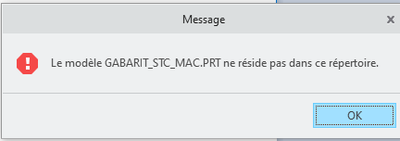

Hello Everyone,
I have an issue with Creo regarding 2d drawing. I can create and do my 2d drawing without issue.
BUT... when I want to re-open my 2d drawing, it does not open and complain that the PART (.prt) template is not in the same directory:
Of course, my template is not in my working folder. The templates are on a shared folder.
If I copy the template .prt to my folder, I can solve the issue on open it... but it's not really convenient. The goal was to have all template on a shared folder so everyone can access to it when creating a new file.
Thank you for your help

Is your part template model assigned to the drawing?  If it is, delete the model from the Drawing Models.

Thank you! I indeed have my part template in the the drawing. I removed it.

There may not be enough context here to define the root cause but if @kdirth did not solve your problem then you should read about search paths. They may be relevant to your issue.
Example: Adding Search Paths (ptc.com)
More details on the configured environment and how you use your dwg and prt templates would be helpful if this remains unsolved.
