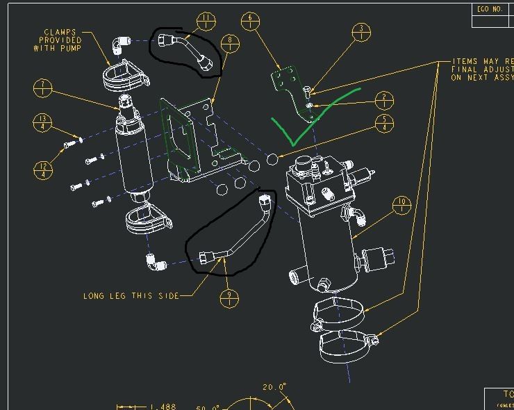

I have an assembly that has two fuel lines made using the pipe feature. (Creo 3.0m150/WC10.2)
I am attempting to make a layer with a rule to collect the pipe centerlines and make it easy to hide them in the assembly drawing. Theyu ;ayer is in the top level assembly. The rule will find the features in the rule editor, but once I hit OK it's a no go. If I go back to the rule editor it can no longer find the feature. The options are set to associative, rule enabled, and independant. What am I doing wrong?

Wrong file attached previously.
cpoirier
(To:cpoirier)
OK, well I made it work but the solution is not elegant. I tried manually adding layers with the pipe features in the parts, even when hiding those in the drawing they will not hide.
Solution:
Make sure all the models involved are checked out including the drawing.
Open the top level assembly (do not use the model tree in the drawing, no way to save status) and select the pipe feature in the part and hide it. Save the status. Save the assy.
Open the drawing.
review>update drawing view>select view and OK
make sure to save status and then save.
I am guessing the old pipe feature is a gray area between solid geom an not as the centerline is part of the feature some how. Is this why the pipe CL will not load with a rule or hide by the layer?
I use the pipe tool all the time for hard lines. Glad I found a solution.
Talk about a real PITA to get what you want.
