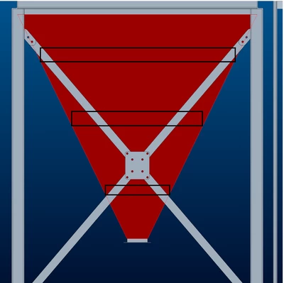

I have a problem, that I need to create pattern of metal sheets (see attachment), that changes his length according to inclination of dump and number of reinforcement (in the picture there are 3 but can be more or less according to type dump). It's only done by extrusion, so it's not assembly but part. Any suggestions how to do it?

Assuming you have a license that includes the top down design tools, use of a skeleton is straightforward.
Create a skeleton model (2D curves and datums) that controls the inclination (angles) of the dump. Add a pattern of curves representing the location of reinforcements. If you align the endpoints of the curves to the inclination angle curves then they will stay attached, you can then alter the inclination and number of reinforcements in the skeleton model . Use this skeleton to control your part models and it will update from the skeleton.
The skeleton could be as simple as coplanar curves shown in green and orange below.

Enclosed is a Creo 7 model demonstrating use of skeleton to drive the plate locations and width. It can of course be much more sophisticated to capture additional design intent if desired. If you can define the location and number of plates as a function of the dump box orientation and size that could be included in the skeleton model using relations to control the geometry. You can manipulate the dump box and plate parts (.prt models) within the skeleton model shown in the tree below.
I have oversimplified the geometry and used surfaces curves/exclusively, but it will work for solid part models.
