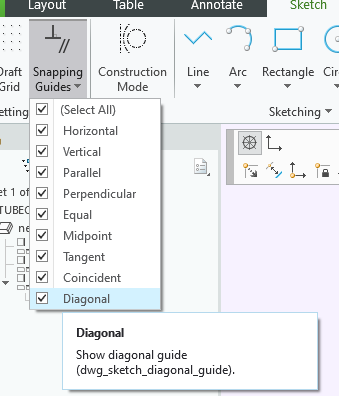

Where did the Angle snapping setting go in Creo 10 for drawing lines at specified angles on drawings?
I can't find it anywhere.
kdirth
(To:DC_6935478)
I don't have 10, but in 12 it is here:  Snaps at 45° increments.  Not sure if that can be changed.
