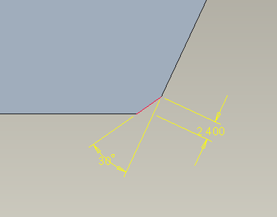

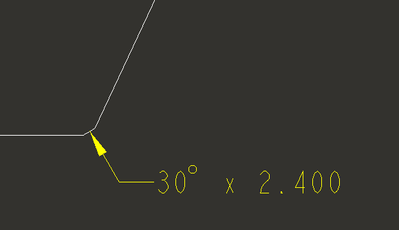

I have used chamfer operation (angle x D) in part, now in drawing when I used model dimensions its not showing Chamfer note but it shows individual chamfer dimensions. How can I have chamfer note in format shown by black ink in image attached? Thanks

With an Angle x D chamfer you will have to make your own note to get what you want.  Create a leader note with "&d* X &d*, using the dimension names of the shown dimensions.
StephenW
(To:umg)

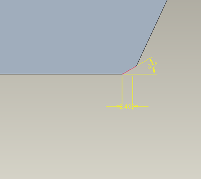

They make it show the dimensions because it can be difficult to tell which direction the angle/dimension is referring to. Your example is very good at illustrating that.
On the drawing, visually, can a fabrication person really tell which direction the angle is coming from?  They can guess.
