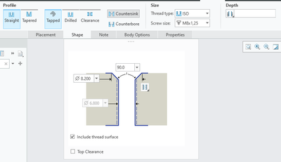

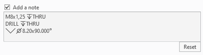

I found that I could add exit counter sinks to holes something that we had not used so instead had an unattached note added to a hole note stating both sides for a double countersink.
We use a combination of simple holes which I also parametrized and ISO standard holes.
In this image it shows the exit countersink option greyed out as its not a through hole which I understand

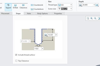

In this image that option is gone, Why?

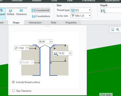

I am in 2 different sessions both in Creo 10.0.6.0. The first image was taken with a part outside OpenBom and the second was in OpenBom, though I don't think that will affect anything
I initially thought that it was due to Creo versions but when I updated to Creo 10.0.6.0 from 10.0.3.0 on a test laptop it did not have the option.
What is defining whether exit countersink option is present in the hole shape?
I think I see where I am going wrong the placement type is set to sketched and not on point. My process for making holes is to make a sketch with datum point(s) and then make a hole when the sketch is selected using a map key which I have set as "HO". I will need to modify this map key to change the type to on point.
When highlighting a sketch and then making a hole it automatically set the type to sketched whereas if you select a point instead the hole type becomes on point allowing exit counter sinks.

Do you have a Hole orientation set in the placement tab?  This setting appears to disable an exit countersink
kdirth
(To:kdirth)
Selecting "All" Bodies also disables exit countersink.
