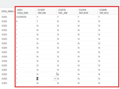

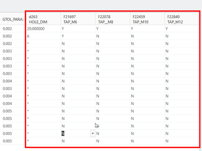

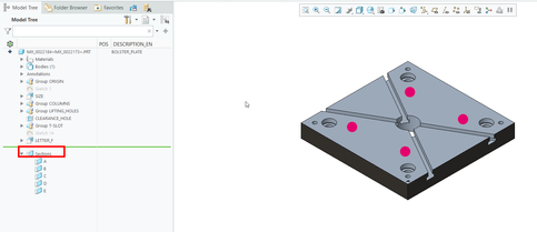

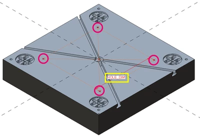

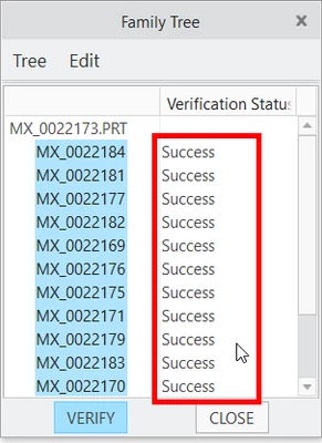

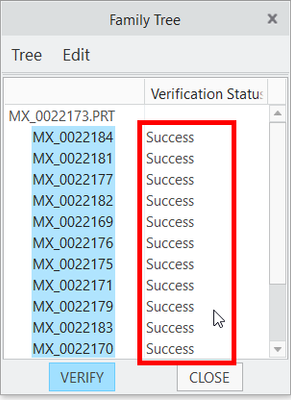

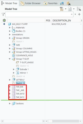

I have this Generic part (Fig. 1.1) for my Family Table. As you can see in Fig. 1.2, they're obviously in the Model Tree. Their columns show in the Family Table (Fig. 1.3) and when I verify (Fig. 1.4) they're successful.
But even if everything shows that the features should show in the instances, they're still not showing (Fig. 1.5). It doesn't look like they were suppressed, more like the were never added to the model.

Fig. 1.1 - Generic Plate
Fig. 1.2 - Model Tree showing the patterns
Fig. 1.3 - Family Table showing the Columns of the Patterns and Dimension
Fig. 1.4 - Family Tree shows the Verification Status: Success
Fig. 1.5 - Features not showing in instances.

I guess your TAP patterns are children of Sketch_15 feature. This features is suppressed in MX_0022148 instance and because of this all TAP patterns are suppressed, too.
If it is possible, pack your model into zip file and upload this zip file.

The TAP patterns were in fact children of Sketch_15, I guess it was due to the transition from Creo 7 to Creo 9 or something corrupt in the model because after the transition it still didn't work right.
What I had to do was change the instances to unique models, deleting the Family Table completely, then go model by model adding the dowel holes.
