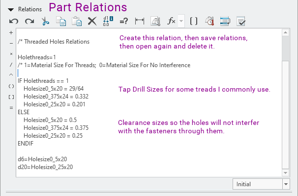

Most of the time I just coast through the interference checks and ignore the fasteners. However, if I know I'll be doing a lot of checking, and a lot of fasteners, I'll use these relations. Works well for cuts that pose as holes (just modify the diameter), but if you use the "HOLE" features, then you'll need to add a cut to consume the inside area where the threads are. Drive the diameter with a relation.
In the PART - create these relations. I paste this whole thing with a long list of common bolt sizes I use. (Sometimes I'll delete the ones I know are not applicable in this part.) Yes, it creates a lot of extra parameters, which is part of why it's convoluted. Oh well. Save the relations, then open it up again and delete the first one, Holethreads=1. That assigns it within the model, but removes it from the relations so it can be assigned at the assembly level.  It will give an error if you past in the relations without that one the first time.  (I know, it's just a backward way of establishing a parameter.)

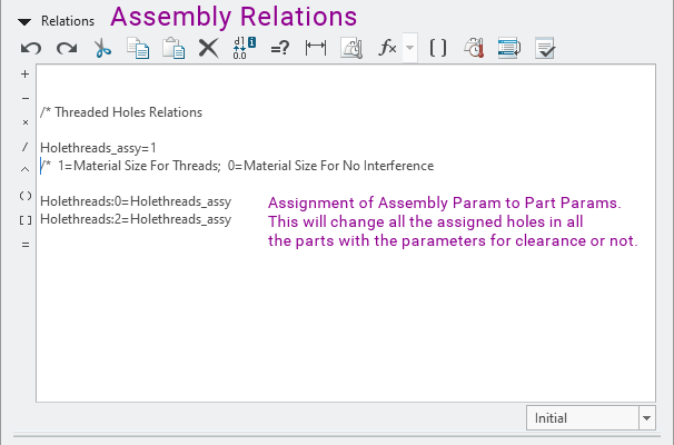

In the ASSEMBLY - create these relations. The :X number is the part assignment so it carries the requirement for threads or for clearance (line to line) to the parts.
In the Assembly you can change the one parameter - either in the relations like here (or in parameters or program) - then regenerate.  For Hole features where you add a cut to consume the thread area, when you regenerate with "material size for threads" you will get this error on regen.  Just ignore it.

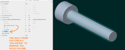

Maybe it was already obvious, but I just thought of it: you can "solidify" the cosmetic thread surface and remove that volume from the solid:pausob_1-1685907325545.png
I suppose another thing to consider is whether you need to worry about the fastener parts at all?
I.e., "prepare" for the interference check by turning your parts with internal holes into the "no-interference" versions where their cosmetic thread volumes are removed...
