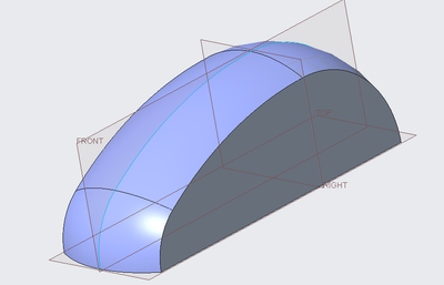

Basically adding a taper and a draft. While doing this I realised my initial sketch that was extruded to the surface was not enough to handle the taper.

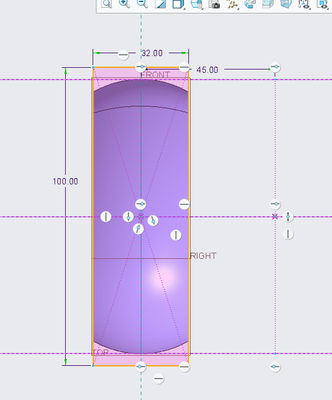

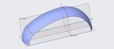

The surface(created using a sweep) and my initial sketch below ( the sketch is a bottom up projection of the surface edges.
When extruding without a taper it works perfectly.
However when I add a taper of 15 degrees to it, the extrusion no longer fits to the surface as nicely as before.
The fix I found for this was modifying my sketch to be taller than the projected area.
This resulted in an extrusion that fit much better to the surface.
I am sure I am probably messing something so I would really any tips on why the projected area extrusion doesn't work.

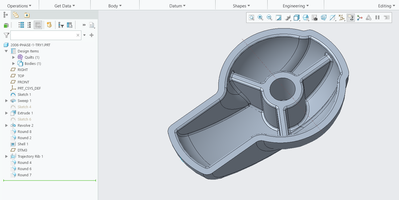

Here are screen shots of both versions with model tree.
Yeah my process was similar to yours.
Might I ask why you chose to add a draft instead of a taper I was under the impression the less features there are the better.
