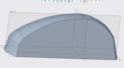

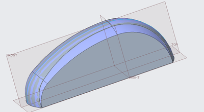

I am trying to recreate this model from solidworks model mania 2006 which consists of two phases, changing your model from
to the one below.
Basically adding a taper and a draft. While doing this I realised my initial sketch that was extruded to the surface was not enough to handle the taper.
The surface(created using a sweep) and my initial sketch below ( the sketch is a bottom up projection of the surface edges.
When extruding without a taper it works perfectly.
However when I add a taper of 15 degrees to it, the extrusion no longer fits to the surface as nicely as before.
The fix I found for this was modifying my sketch to be taller than the projected area.
This resulted in an extrusion that fit much better to the surface.
I am sure I am probably messing something so I would really any tips on why the projected area extrusion doesn't work.
I am using creo parametric 9.0 student version

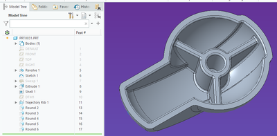

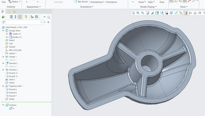

Here are screen shots of both versions with model tree.
IbrahimTayyab
(To:kdirth)
Yeah my process was similar to yours.
Might I ask why you chose to add a draft instead of a taper I was under the impression the less features there are the better.
In general I try to keep fewer features in my models.  However, I also try to consider what the design intent is and how I am going to dimension the drawing.  In this case, I used projections of the ends of the surface to sketch the extrude. simplifying the sketch (no dimensions needed).  I also normally name the features in the tree to make things easier to modify in the future (many of my models have more than 200 features).
Here is a molded part with 571. (mostly surfacing):
IbrahimTayyab
(To:kdirth)
Oh I think I'm starting to understand by using the taper inside the extrude I am bunching them together and thus creating some confusion. If I instead use the draft feature it is much clearer and easier to change going forward as well, as the feature itself is distinct. I didn't think of it like that, thank you very much.
