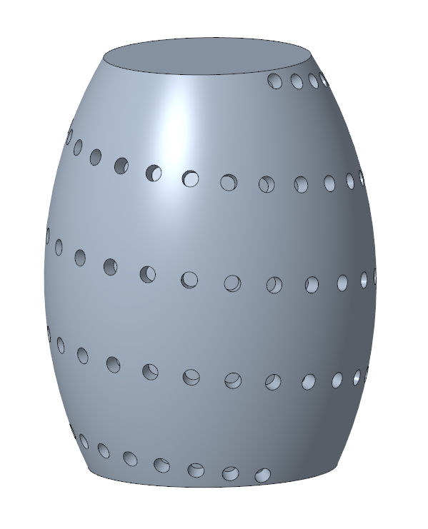

I am using Creo Parametric 12. Can anyone share an idea, how I can do a helical pattern of this small hole over this round surface?

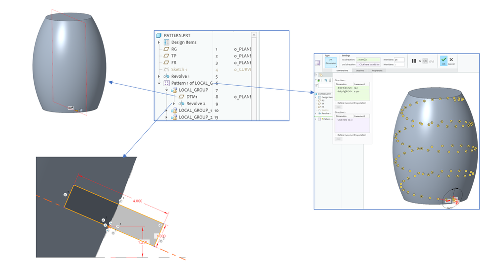

You may consider using dimensional pattern as shown below:
In this case the holes are always normal to sitting surface. Hope this is helpful to you.
