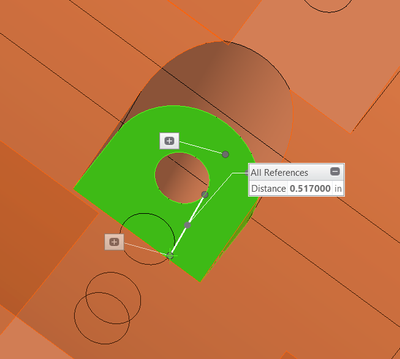

Hello all,
Would anyone know why a model would display hidden lines when the display setting is "shading with edges"? I have included a screen capture of a portion of the model.
I thought there may be a setting for Hidden Line Removal that was modified by a user, but didn't find anything like that on the web.
Using Creo Parametric 8.0.1.0
Thanks in advance,
Phil

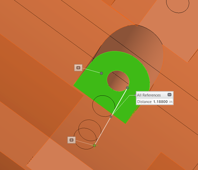

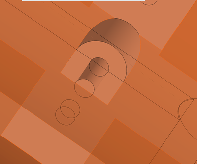

All,
I finally figured out the problem. I had a dimension on the first feature that was causing the issue. It was waaaay out in space as shown in the picture. When moving the dimension around, it is evident something is wrong. When I deleted that dimension, it fixed the problem. I attached a before and after picture.

The offending lines appear to be very close to the surface.  Edges will show through the surface depending the distance below the surface, zoom level and display settings.
Here is a bolt head set 0.05mm below the surface:
It disappears when I zoom in.
Phillip1
(To:kdirth)
Thank you for your reply.
Here are a few more pictures. The first shows some hidden lines and the next two show measurements to the feature showing through.
KenFarley
(To:Phillip1)
Usually when I have display issues with hidden line or shaded with edges I find that it's one of the following:
(1) If it's an assembly, it's usually an interference between two components
(2) For a part, it might be that the model is an old one with the horrible "relative 0.0012" setting. Usually a quick fix by regenerating the model with absolute accuracy - I like 0.00001 inch.
(3) Also for a part, sometimes it's because a surface that a hole is supposed to go "until" is a little quirky and I need to instead use "thru all" or a specific depth that is deep enough to get through where I need it.
(4) I've found models where someone did a cut over a cut (using the edges of the part to cut the same contour "a little deeper". This caused weird extra edges and "remnant" stuff to appear. Fixed with a re-ordering of the features and other structural fixes.
The cylindrical cut that is thru the part in your picture looks odd, in terms of the squarish surface "patch" that seems to be around the hole.
Phillip1
(To:Phillip1)
All,
