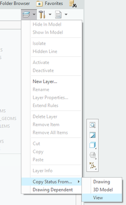

I have a drawing with 5 or more views where I've customized the layers on and off.
The layers on and off are the same for each view.
With PDM, I swap a part in the assembly, where the AA layer is hidden, with another similar part that also has the AA layer.
In the parts, the AA layer is always hidden.
Once I regenerate the 5 views in the assembly drawing, the AA layer of the new part is visible again, while the remaining hidden ones remain hidden.
Now I have to manually intervene on each view and re-hide it.
Even though the two parts are practically identical (small, non-essential things like rounding and dimensions change), why does the layer reactivate in the assembly drawing?
Why does a layer hidden in the part reappear visible in the assembly drawing while, correctly, it remains hidden in 3D?
To avoid doing this for every single view of the assembly drawing is it possible to hide the layer in a single operation by selecting all the views and simultaneously hiding the AA layer?
I haven't found a way; it only hides in the last view selected.

The "draw_layers_new_model_show_all" defaults to "yes", which makes all layers of a new model shown. You could try changing it to "no" and see if that makes it easier for you.
To change the layers of views, you can add the "copy status from view" to the toolbar and select the desired view. That still means having to change to each view, though.
You could also try using ModelCheck to be able to change the layers of all views at once. I'm not sure if that can be done.

The draw_layers_new_model_show_all option to set in my WF4 version doesn't exist (at least I haven't found it).
The commands you describe are the ones I use.
It would be convenient to be able to select multiple views (to edit) at the same time and associate the basic view properties with all of them instead of doing it one at a time.
This would save time.
