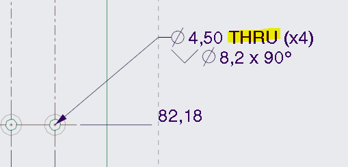

Hello all,
I upgraded from Creo 4.0 M020 to M030 and since then, my hole notes are in English. Before they were in french. I tried to add "ENV=PRO_LANG=french" to the parametric.psf file but it doesn't solve the problem.
Before I had it in french, for instance "A TRAVERS".
Any idea to solve this ?

silly question ... did you select French option during installation ? Is Creo UI in French language ?
Also ... I do not recommend to do update installation.
Martin Hanák
Hi, well this is not silly. I did select French option during installation and everything is in french except  hole notes.
Yep I shouldn't have done an update... Smiley Sad If I want to go back to M020, do I have to do a fresh install ?
