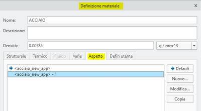

Hello everyone,
in the sheet of a material it is possible to associate one or more coloring aspects to it.
Trivial to create them, modify them and set which one should be the default, but I have not found any way to delete them!
Can you tell me how they can be eliminated?
P.S. I use creo 9.0.0.0

I think you can open material file in Notepad and remove unwanted line from it.

Thanks for the reply Martin,
I find that not having provided a native delete command from the program interface is a very bad thing ... not to mention the problem of instability of the color aspects associated with the materials of the variants never solved (see CS33983) ...
