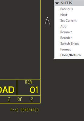

Assuming access hasn't changed (I am on Creo 4), you can access the old menu manager and use next sheet/previous sheet also.
You can tell it's an OLD mapkey because it uses "done" to help back out of those awesome old menu manager commands, LOL, that brought back a lot of memories!
mapkey < @MAPKEY_LABELPrev Sht;\
mapkey(continued) @MAPKEY_NAMEGo to the previous drawing sheet (d);%~done; %~done; #Sheets;\
mapkey(continued) #Previous;
mapkey > @MAPKEY_LABELNext Sht;\
mapkey(continued) @MAPKEY_NAMEGo to the next drawing sheet (d);%~done; #Sheets; #Next;

your mapkey works even in Creo 9.0. Do you remember in which version it was created?
Martin Hanák
StephenW
(To:MartinHanak)
@MartinHanak
Definitely pre-wildfire. I have some old configs that say 2000i release but most of the stuff in them would have been copied from before that.
