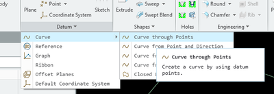

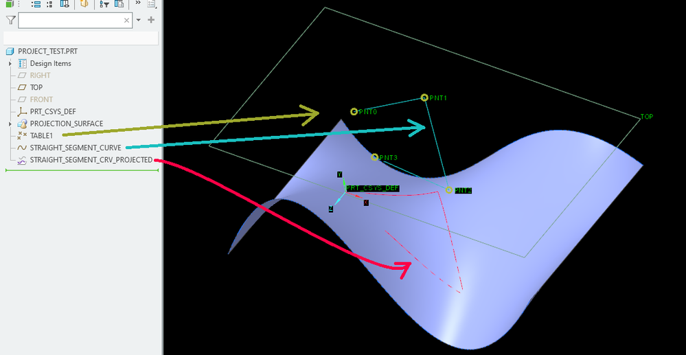

Given your objective, may I propose this workflow:
1) import your points as you've done already and generate the TABLE1 datum point feature
2) create curve through these points
(make it a straight-segment type of curve)

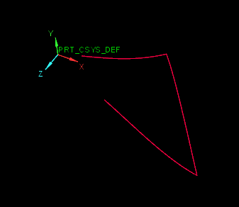

3) project the curve onto your surface
4) Hide everything except the projected curve

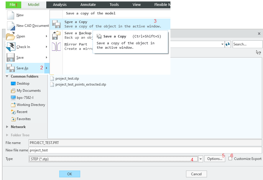

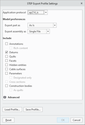

5) Export as STEP. Make sure you tick off the "Export Datums" checkbox

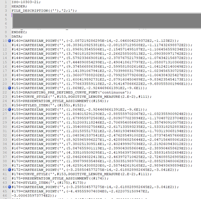

Then parse the step file in your favourite text editor - the endpoints will be evident as the first and last CARTESIAN_POINTS of each segment:

Step 5 is to save you part as a STEP model:
(If you check off the "Customize Export" box, then you have the option of choosing the coordinate system that the exported data will be based upon)
STP files are text files that can be opened in a text editor.
