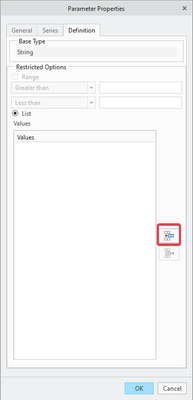

To make a drop down list of options, there are two methods.
1. Using .lst file
Example:
ND_ParamDefArr_K01 = {
{ Name = Maker
Type = string
Default = 'ミスミ'
Enum = { 'ミスミ', 'SMC', 'キーエンス', 'CKD', 'IAI', 'オリエンタル', 'オムロン', 'コガネイ', 'THK', 'CSS', 'SUS', 'ユーザ入力'}
2. Using user interface
