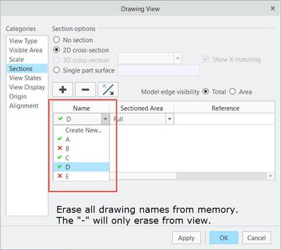

I would like to be able to erase the drawing names from memory in the pull-down under Name.  Selecting the "-" will not erase the names from memory.  Can this be accompolished?  I am using Creo 6.0.0.0, and thanks in advance.

The screenshot is showing sections that are created in the model. You can go to the model and delete the section.
If you want the view to not use a section, select the "no section" option instead of the "2D cross-section" option

That is correct.  When I created a 2-D cross-section from the drawing, it made a drawing section in the model tree.  Thanks.
