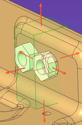

(see attached)
from the FRONT view, I left click and drag to select all the cylinders,
but any cylinders on the BACK in the drag box are also selected.
I want it to only select things visible in my current view.
In this example I only want it to select cylinders on the FRONT.

Will the 3D box select accomplish what you want to do?
