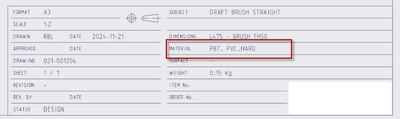

I was hoping I am able to control the reported material somehow. What if you have for example 10 different materials used in one part, then the length of the generated PTC_REPORTED_MATERIAL become a bit lengthy to show in a BOM list on a drawing.

  • Using multi-body with different materials gives a list in PTC_REPORTED_MATERIAL
  • Adding this PTC_REPORTED_MATERIAL to a repeat region and set ptc_reported_material_in_region to multi-material shows  a nice horizontal list of the used materials in case of muti-body with different materials (so "&PTC_REPORTED_MATERIAL" results in "Steel, Wood" for example) (sse also screenshot below).
  • The ptc_reported_material_in_region option is not available on model level (only on drawing level)
  • It is not possible to use this PTC_REPORTED_MATERIAL in a relation
  • An assembly has no parameter PTC_REPORTED_MATERIAL
The challenge we have is
How to get this PTC_REPORTED_MATERIAL correct designated to Windchill?
How to set this in the drawing template? As an assembly has no PTC_REPORTED_MATERIAL, the template cannot be the same for a part or a drawing, that's not really convenient.
Currently we have solved this by using the parameter MATERIAL and a relation on parts to fill this with the material description and for assemblies set a relation to leave this parameter MATERIAL empty. So we can display this parameter MATERIAL on the drawing table. And also designate this parameter MATERIAL to Windchill.
Looking at the multi-body situation, it looks like PTC wants us to use the PTC_REPORTED_MATERIAL but I get the feeling they didn't make a complete usable solution...
