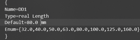

When I learn about restricted parameters, I notice that there is no showcase about how to correctly add <quantity type> and <unit>. I have attempted to create some files but they are not accepted by Creo.
Can anyone give me some examples about adding quantity type/unit?

@Luc_G wrote:
Below is my new attempt but failed to be read by Creo.
When I delete "Length" & "mm" it is read by the system but when I update my exsisting parameter DD1 it says wrong type or unit.
every Enum value must be followed by mm.

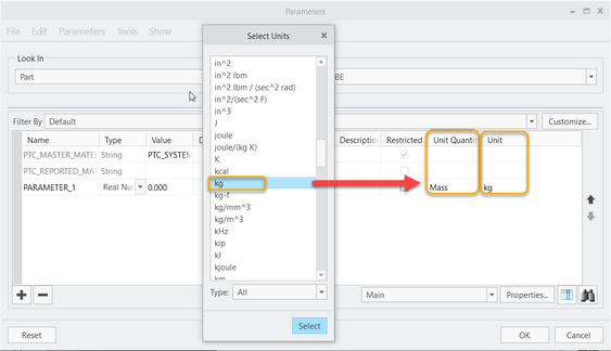

Hello @Luc_G
Before creating the restricted parameter file, just create a simple parameter from the User Interface, Right click on it, and select Insert Unit.
After that, you will see the Quantiy and the Unit syntax expected in the restricted parameter file definition.
For instance, if you insert "kg" as "unit" from drop down list, you'll see that unit will be kg (without surporise), and Quantity is Mass:
Once having acknowledged this information, build your restricted parameter file using syntax according to guidance from article 123992.
Hope this helps,
Serge
MartinHanak
(To:Luc_G)
Martin Hanák

Thanks a lot! Now it works, finally.
