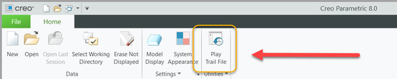

        1. Manually modify the trail file to "delete last lines", able to configure the steps of the session BEFORE the exit (operation not officially supported by PTC Technical SUpport, but nevertheless working and helpful in some tricky situations)
        2. RESTORE initial conditions, before playing trail file again as follows in this snapshot (and RESTORING initial conditions is often the MOST challenging point, even for experienced users, sometimes just not possible) - but if they succeed, they avoid by this way the "data loss" produced by the given session which previously exited unexpectedly.

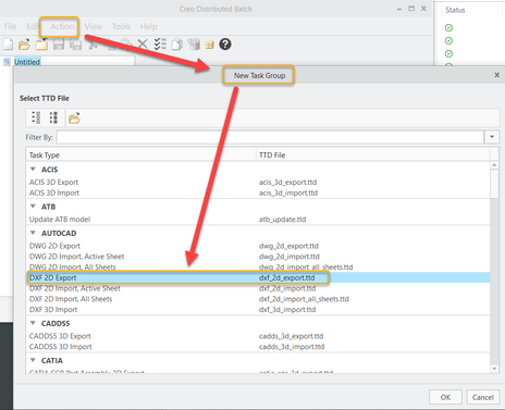

Hello @KenFarley
Thanks to have shared your experience with trail files. This is a very good example of when it is needed, and how to deal with this.
For the future, let me however share an alternate way for this buisness need, which will be probably easier for you than reworking trail files (which is never easy). Consider maybe usage of Distributed Pro/BATCH (from <Creo Parametric load point>\Parametric\bin\ptcdbatch.bat utlity) where you can access a task named DXF 2D export, dedicated to generate DXF files from multiple drawings in batch (no UI) from a list of existing drawings:
If you're interested in this approach, you'll find further technical details on Distributed Pro/BATCH in Help Center here, or in Central Resource Article 139340 here.
Serge
