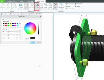

My issue was I have a .pvz file which has no colour and I wanted to apply colour to it. It's a big assembly file and I try to export it to .step file and try to apply the appearance to it but the creo is crashing while opening that assembly file. So i need help that how can I apply colours to .pvz file in creo illustrate
1. Creo Illustrate:
2. You can export the step file with colors from CREO parametric.
Use ap214_is protocol to export with colors:
3. use Creo view

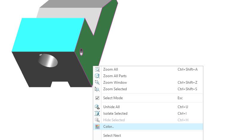

If you have a PVZ, then why not open it in Creo View to color the surfaces separately. Select the surface, right mouse button, then color. We do this all the time, especially for Design Reviews.
Hi @llie the .pvz file I have is a single body, so I was not able to select the surface separately, (when i applied the color the whole part is painted in one color). I tried to select it as per your method but it didn't work.
In Creo View, not Creo Parametric. First click selects the whole model, then second click selects the individual surface.
