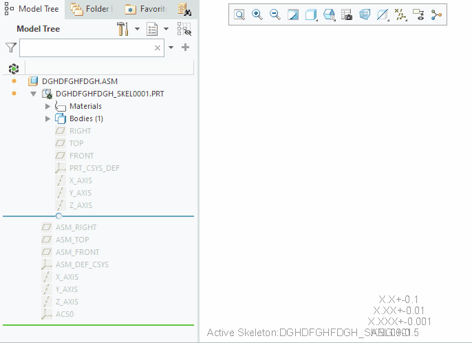

1. If you don't have access to skeleton models you can use just an empty part model that holds your CSYSs or just place a bunch of CSYSs at the new assemble level.
2. Once you make your new assembly and skeleton, assemble it into your existing assembly. Then activate the skeleton in your new assembly. Then create a new CSYS feature and place it on top of the electrical box default CSYSs. Before closing the dialog box click the skeleton CSYS. This will then cause Creo to copy all of the CSYS transformations into the new default CSYS without the need to make a transformation matrix measurement. After you have closed the new CSYS dialog box you can now go back into your new assembly and assemble the electrical box on the new CSYS that you made in the skeleton model.

If I understand correctly this is one option. This assumes that you have access to the top down design tools (skeletons).
  1. Determine the relative position of the boxes to add csys or other datums to a skeleton to be created in a new assembly. Use csys transforms if possible.
  2. Create a new assembly model (i.e. electrical boxes)
  3. Create a skeleton model that defines the location of each box relative to datums that make sense for placement into new assemblies. This will be used to position the electrical boxes and other items as required.
  4. Add the boxes etc. to this new assembly model.

When following your example above is a reference to the existing assembly created when activating the skeleton within this assembly (existing) and copying referencing csys features? If so, that is an important detail as you would create a dependency on the existing assembly that would need to be managed for the new assembly of electrical boxes.

If you didn't change the reference to be the default CSYS of the skeleton then yes there would be an external reference. When you complete the second step of clicking the default skeleton CSYS though, you remove the external reference and change it to the local skeleton CSYS reference.

This will indeed save the step of creating measures to determine csys offsets. I was not aware of this ability to make independent the reference during feature creation in a skeleton. You would need to follow this process for each csys you need to extract from the existing assembly into the skeleton, but it will streamline the process.
