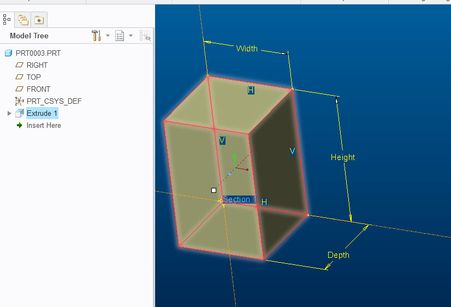

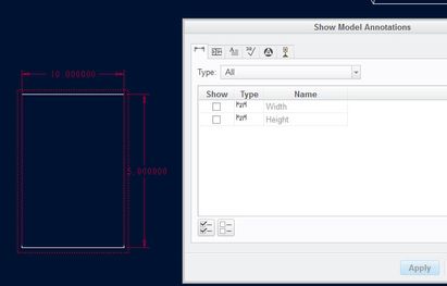

It is possible, but for that you need assign name to diemnsions at part level. (As in below images).
E.g. In part mode select dimension > Right Click > Properties > Enter name
Part ModePart ModeDrawing modeDrawing mode
