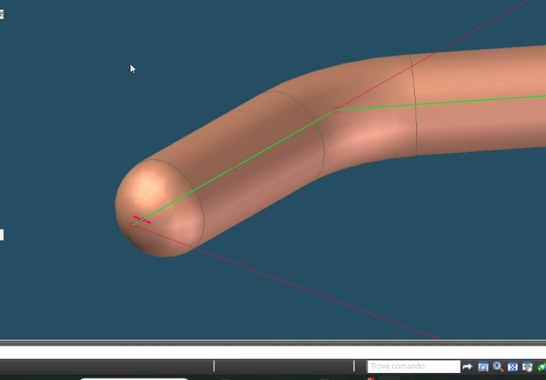

How to do pipe end Forming/treatment in creo piping?
How to do pipe end treatment in creo piping?
Copper pipe end requires Converging/diverging profile at the end depending on the fitting size. Also the pipe end made it round using pipe end forming techniques. is it possible to do pipe end forming methods in creo piping?
Below images are the anticipated shapes (Created in different CAD system, not in creo)
2 REPLIES 2
I don't think there is. You can make a "fitting" for the desired end style and install it to the end of the tube. We use a flared end on a lot of our tubes, so we just added a separate view of the flared end and specify for the tube maker to allow enough extra tubing to flare the tubes.
