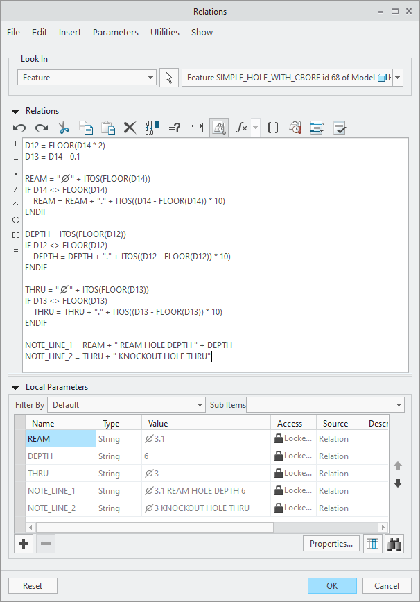

Fundamentally you can't do "math" in a note.  You need to find some way to calculate the value somewhere else and then just refer to the result in the note.  As @Chris3 stated, it's probably easiest/best to just adjust the .hol file so it actually generates the hole geometry AND the hole note with the value you want, but if that's not an option then you will probably need to use feature relations inside each hole feature to drive a feature specific parameter that you can reference in your note.  Of course the challenge with this approach is that you will need to modify each and every hole feature you create.  Mapkeys can help with this, but it's still a departure from the 'out of the box' approach provided by the hole feature.

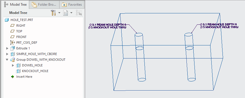

Take a look at the attached model and corresponding UDFs.  There are two different methods shown - one using a single hole feature and one using two hole features in a group.  These will automatically update the notes and clearance holes as the ream hole changes size.
Pay attention to the feature relations present in the different hole features.
Keep in mind that these were just thrown together for demonstration purposes.  There are further refinements that should be done before putting into production.
