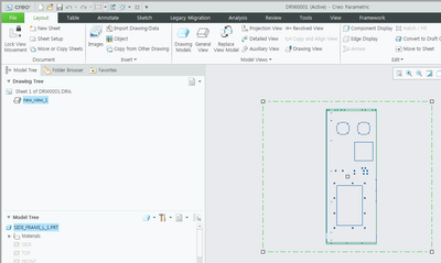

There are hidden external geometry copy data as pictured.
That hidden feature leaves the view blank.
Is it possible to prevent the hidden state of external features from appearing in the view of the drawing other than a simplified representation?

Your question seems to be for Creo Parametric. Here you are in "Creo Elements Direct Drafting". You should change your post to "Creo Parametric" to have an answer from this community.

Unhide the layer it is on in the drawing or remove it from the layer if it does not need to be hidden in the model.
