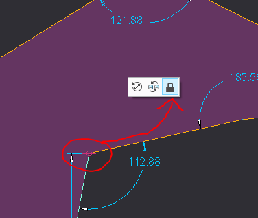

You can select a point or line, Right Mouse Button --> Toggle Lock
