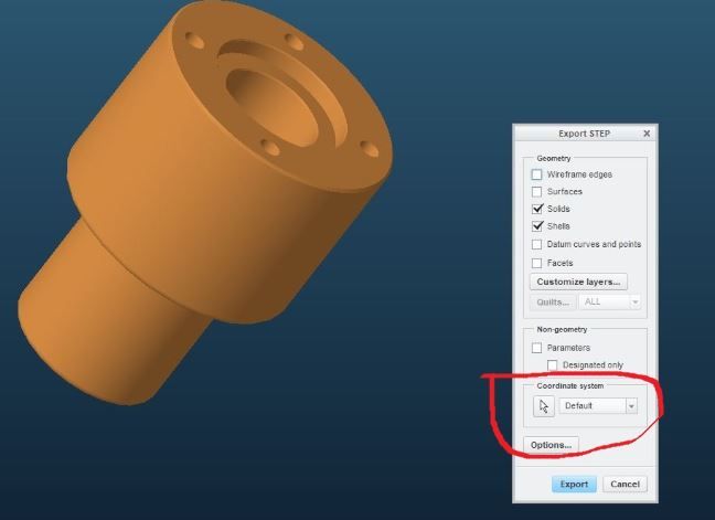

In CREO 3.0 when exporting a STEP file the "Export STEP" dialog box came up and gave you a option to select a CSYS.  In CREO 4.0 this seems to be gone . Where can I find this option in CREO 4.0 ?

In Creo 4 select the customize export box in the lower right corner of the window after selecting STEP as the file type for export. This will open a window with the select Csys option.
